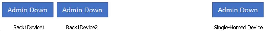

Complete Failure Topology
- Topology having at least one
single-homed device in admin down state or atleast one dual-homed device
pair with both the devices in admin down state is a “complete failure
topology”.
- Any Tenant CLI or REST API of
create or delete nature attempted on the target devices having “complete
failure topology” is rejected with an appropriate error and result in a
complete failure. XCO does not have any configuration recipe prepared for
this REST API or CLI as the entire request is rejected. For example, an EPG
(endpoint group) create attempted on a single-homed device which is admin
down state.

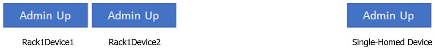

Complete Success Topology
- Topology with all the
single-homed devices and all the dual-homed device pair in admin up state is
a “complete success topology”.
success topology” results in the configuration recipe preparation for all
the target devices and the configuration is attempted on all the target
devices as all the target devices are in “admin up” state.
